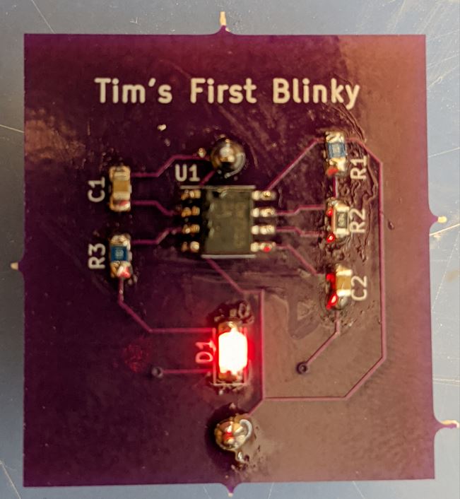

It definitely shows that I went weeks without practicing soldering. The first capacitor was extremely difficult for me, but it got easier as I went through. The R2 was the last 0806 that I put on, and afterward I added the led and the battery holder.

Looks great to me! If you have any isopropyl alcohol and a soft brush (like a worn out toothbrush) a quick sluice and gentle scrub can often remove the flux residue and make the board more aesthetically pleasing and less sticky! Depending on the flux used, you may want to remove it because some are corrosive over the long run and can eat away at traces and joints. But that won’t stop you from having a successful Blinky, so it’s a minor consideration.
Thank you for the response @smerrett79 . I did apply some isopropyl with a cotton swab, but it is pretty evident in the picture that I didn’t do a thorough enough job. It may partially be because I only bought 91% since my two year old wanders near my work bench.

Sorry, as I said I’ve been away (family emergency) so I’ve not been able to scrutinise your PCB on a large screen until now.
As @smerrett79 mentioned, it could do with a good clean. Don’t worry about hitting it with isopropyl alcohol, you won’t do any damage. Even soapy water works providing you let it dry fully. Otherwise, it looks fine - a little bit more practice and you’ll be perfect. The lower side of C1 is what you’re aiming for.
