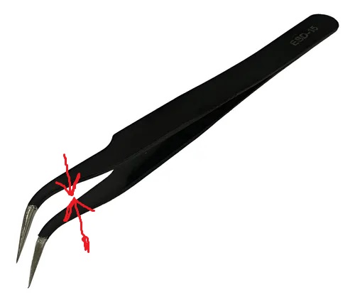

Question tweezers
Storing electronic tweezers closed with the plastic protection on the nozzle for many years will cause misalignment, loss of pressure, and deformation in the electronic tweezers? Generally, tweezers are somewhat open.
