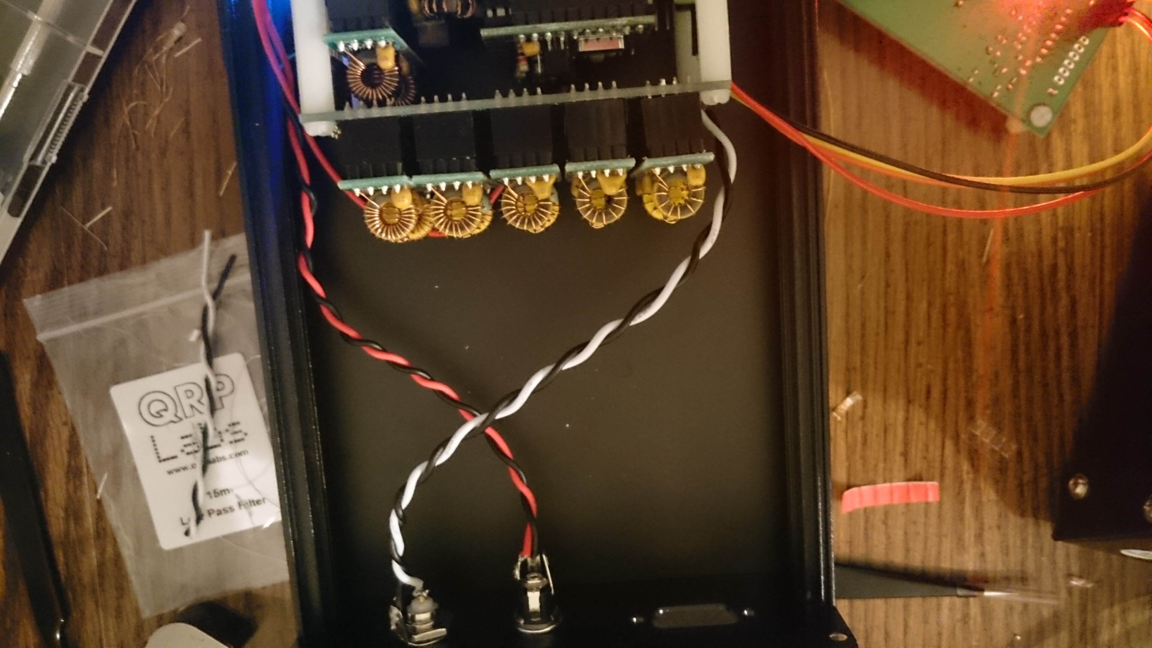

Also built a beacon radio from a kit, was generally functional, but had low output power. Turned out to be a toroid that wasnt making a good connection. It passed my initial check due to me having the multimeter probes on the wire, but the enamel was not removed well enough to make a solder connection. This is apparently a common problem with the enameled wire used with toroids, but the point I learned was to check for continuity downstream and upstream of them to ensure a solid connection.

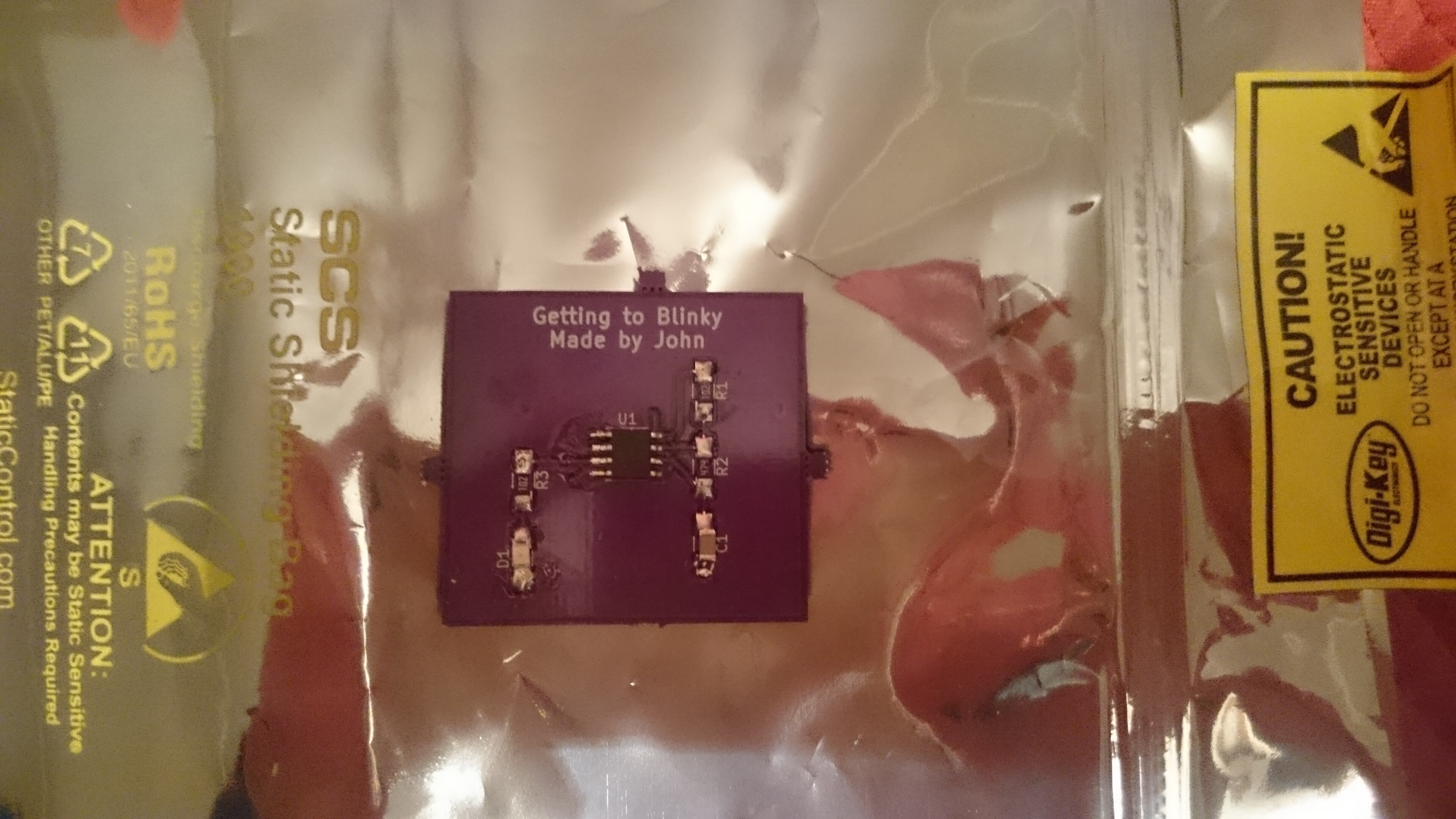

CE related I built the getting to blinky board today, which I think may have been some of the worst soldering I’ve done in a while, but it worked from the very beginning (I knew about the ground issue from the video before I sent to fab), so I can’t complain. I also got the CE Header border and tinsy so I can put some headers or something on that. Just started the sensor board videos.
