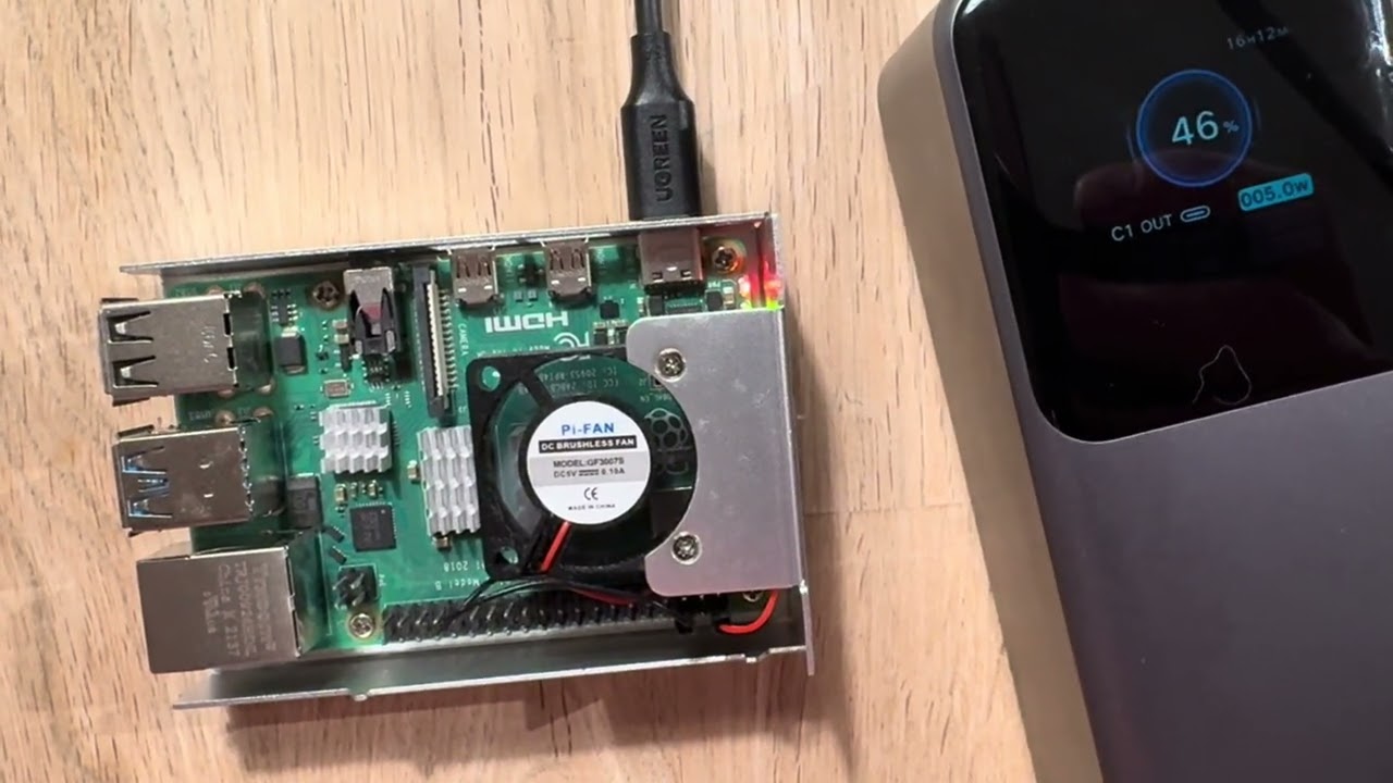

A little video - I stopped too early just before the green LED went out! Drawing 5W

After doing a load of debugging, checking voltages etc - it’s dead Jim! Stone cold dead - the USB chip gets surprisingly warm but it doesn’t even appear to be loading the initial bootloader
