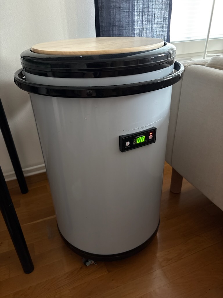

I’m trying to convert a small fridge I have for use as a fermentation chamber for beer brewing and wanted to check if doing so would be problematic at all. The aim is to be able to keep the fridge at a stable temperature of my choice - between 18° and 23° (the general range of temperature for ale yeasts) For lagers, where I would want to ferment at 12° I can use the inbuilt fridge controller (which has a max setting of 16°). My ambient temperature is 24°/25° - as I don’t want to add a heating pad, I am limited by the ambient temperature.

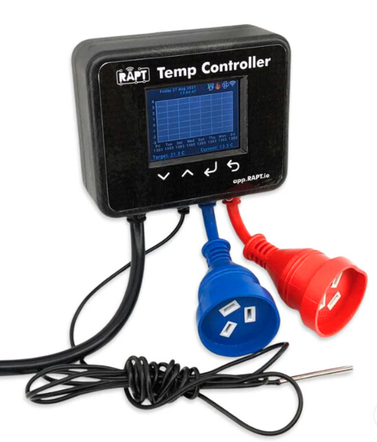

I’ve bought a temperature controller from KegLand in Australia ( RAPT Wi-Fi Temperature Controller Box | KegLand ) (the European model, of course with the correct plugs!) which as far as I can tell uses a temperature sensor to just cut and activate the main power to the fridge (it does have a secondary outlet for a heating pad, but I will not be using that). In the image below, the fridge plugs into blue; the heating pad to red.
The controller has a lot of options and configuration settings - which can be seen here: Menus | KegLand RAPT Portal Help - in summary (and of most interest)
  • it can use the inbuilt sensor shown in the image above, or can attach to a remote bluetooth sensor
  • Cooling Hysteresis: Sets the cooling hysteresis (range 0.0°C-10°C, default 1°C)
  • Heating Hysteresis: Sets the heating hysteresis (range 0.0°C-10°C, default 1°C)
  • Compressor Cooldown: Sets the minimum compressor delay (Range 0-10 minutes, default 5 minutes)
  • Allowed Sensor Diff.: This sets the allowed temperature differential between the built in probe and the current setpoint when using a Bluetooth device for temperature control (range 1°C-50°C, default 5°C)
You can set profiles that will automatically adjust the set-temperature based on fermentation conditions (if you know, you know!) … so pretty cool! But at its heart it just appears to be enabling/disabling the mains to the fridge in response to the set temperature point vs current temperature sensor.

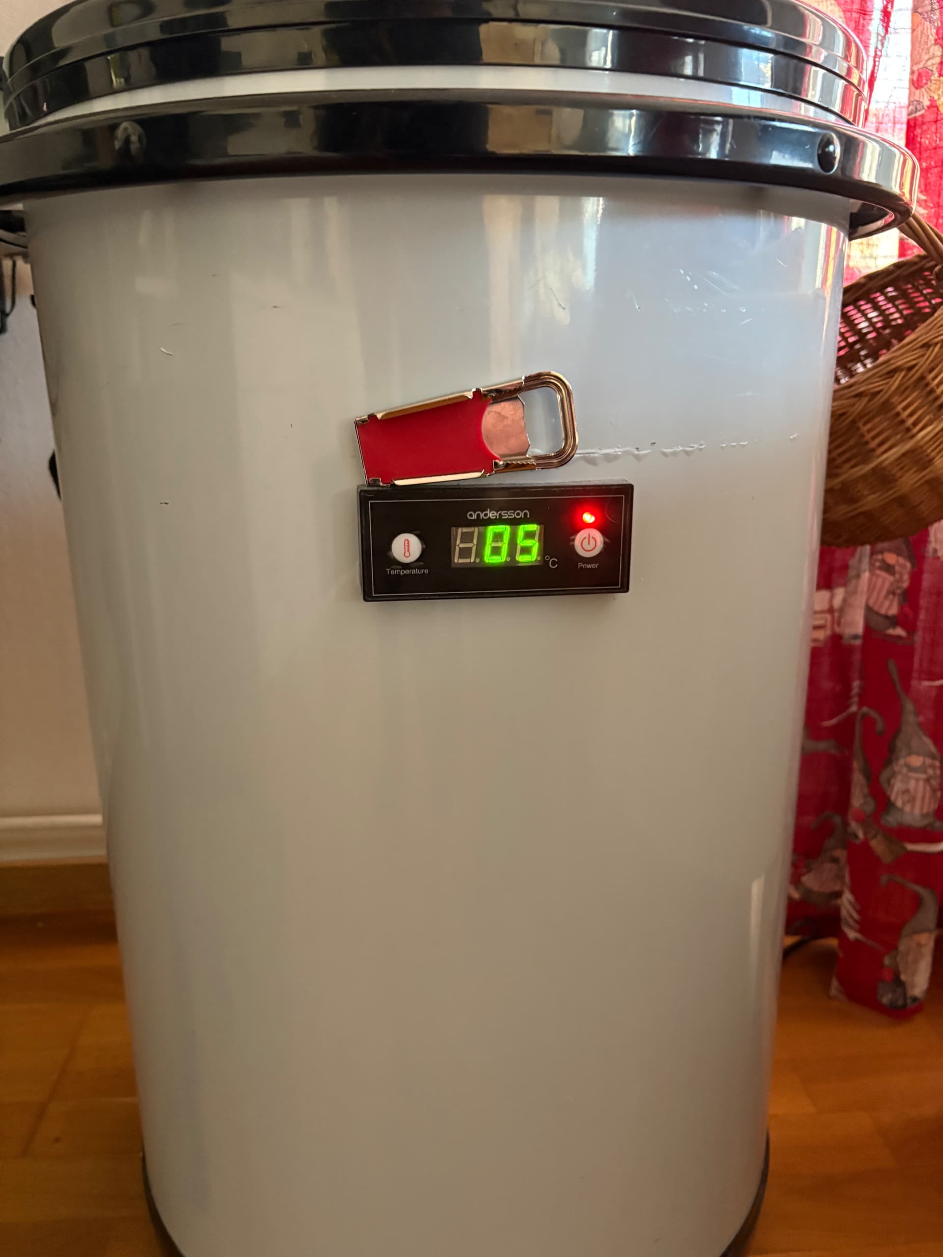

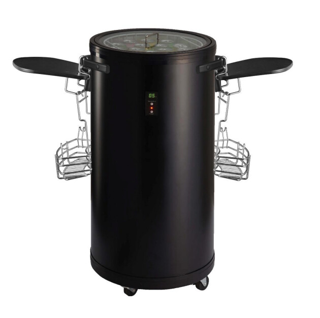

I have seen these (and others like Inkbirds) used on “standard” fridges (and freezers) however in my case, the fridge has some extra electronics (like most modern fridges I guess) and wondering if that’s going to be any issue? The fridge is one of those round party cooler types
(the actual product page if that helps is here: Andersson PartyCooler PYC 3.3 | NetOnNet )
The fridge has a max set temperature of 16° but the display knows that the temperature is higher - turning on after vacation it will show 24° for example which is ambient in my apartment. My speculation is they factor a lowest likely ambient of 16°; to “cool” to a higher value might not be possible (if ambient < requested temp) otherwise it appears they could just allow you to set a higher value!

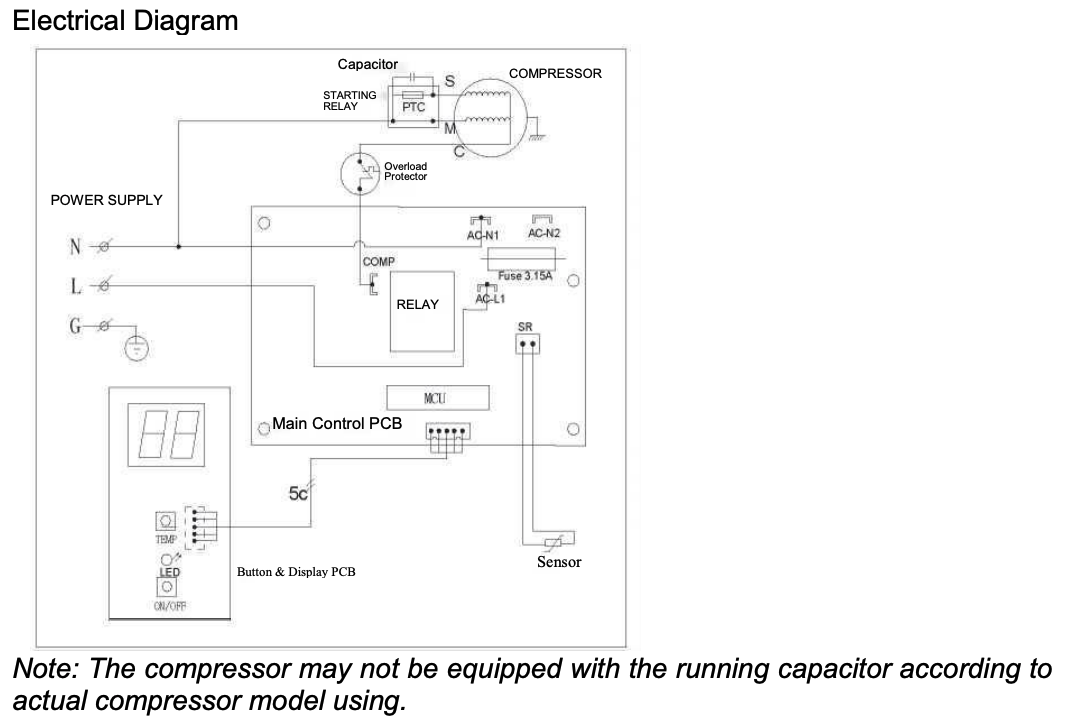

Looking around on the internet, I haven’t found the exact schematic, but the following appears to be pretty close (and what I would expect)
(the above schematic is from this Party Cooler manual: https://img.karkkainen.com/kayttoohjeet/Kayttoohje_6438014380728_6438014380735_Cooltron_50L_75L_kylmasailio_FI_SV_EN.pdf - as you can see, they look slightly different, but same idea. It has the same 0-16° settable temperature range)

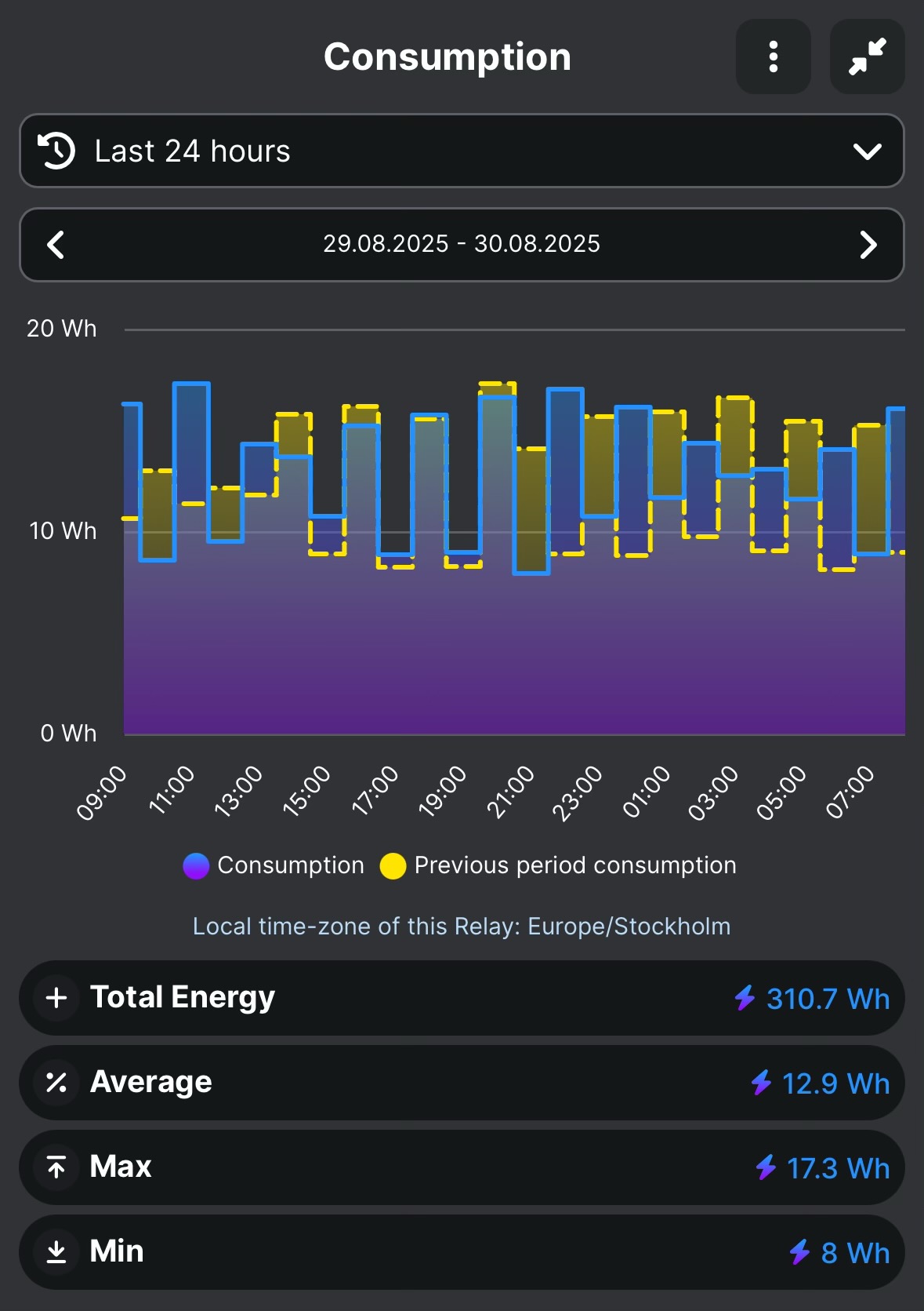

I’ve had it plugged into an energy monitoring smart meter, and collected the below screenshot
From the above, it appears the idle draw is 8W (when the compressor is off), and 17.3W when the compressor is on (is this right? Idle seems too high..?)
As mentioned above, the aim is to have a stable temperature from 18° up to ambient (25°). But looking at the above, in addition to the better temperature control. i can imagine power savings to be had as the fridge will be switched off completely, not drawing 8W idle! Additionally I had a situation where the internal temperature sensor got very confused (not sure why) and it was reading 25° even though the fridge contents were ice cold and there was ice on the walls. The compressor would turn on, run for a bit. Turn off, then immediately turn on again. I have only experienced this once, but an added bonus would be an external temperature sensor could prevent that from happening.

Normally I’d say it’s totally acceptable to plug the whole thing in through the external controller, set the temp as low as possible on the fridge itself, then let the external controller cut all power to it. I think that’s mostly SAFE here, especially if you use the compressor cycle limit functionality on the external controller.
But if you find you need, or simply want, the internal electronics to be powered all the time, I bet the least-intrusive strategy would be to wire your external controller in series with the PTC on the compressor. Then the internals are always-on, built in protections are still present, and the compressor simply won’t be on as frequently as the internals would like. (That could be a problem if the internals have some kind of feedback to detect a compressor open circuit.) I probably wouldn’t use the mains-style one you’ve got now for that, but rather a more hard-wire DIN style controller or something, since you’ll need access to both relay terminals rather than just normally open mains live.
@alexw awesome mate - you actually answered a question I forgot to add - which is fridge temperature setting, my assumption was as long as it’s lower than the required setting the fridge controller will always try to cool to that set point … it just might not get there before the power is pulled. But the lower you set it the more flexibility you have. My thought here was if having the programmed temperature close to the desired has an impact on the way the MCU will control the cooling .. maybe it runs the compressor shorter with lower duty cycle when it’s close to the set point? No idea - could test I guess
as if on cue though, my fridge decided to ignore the fact that I asked for 8° and went to 5° - I think is has something to do with the fridge being half full after Christmas instead of pre-Christmas levels. Put a couple bottles of apple juice in and it stabilized. My hope is an external controller with its temp probe in a bottle of water will improve stability.
I need to work out the best configuration settings for balancing stability and reliability - longer compressor cooldown and wider hysteresis
EDIT: the low-temp reading happened again after removing the juice etc; refilled with drinks for new years and it’s fine again. What is interesting is the fridge has been low on contents before, and not had this problem - I suspect it’s due to the front half of the fridge being empty where the inbuilt temperature sensor must be (normally it’s a bit more random on where drinks are taken from) - conclusion is a better temperature sensor placement and external controller should fix that
