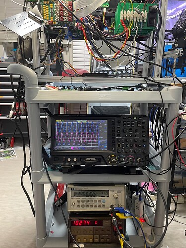

Already happy that I followed the suggestions here! The new standalone scope is really nice!
What did you go for?
Pretty close the the lists above! Thanks for the advice
I’m feeling outclassed with my ancient Keithley 195A (but it was only a couple hundred bucks, as I recall). Warning, gear with non-backlit LCD displays, like that HP 5384A frequency counter, can be hard to read in normal lighting. Although it seems very clear in the picture, I have to keep a flash light handy to read it normally.
